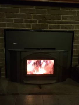

Wind has now shifted to West,still around 25mph,though gusts are fewer and farther between.Winds were fairly turbulent this morning.Outside temps are around the same.Current fire is doing good(keep in mind it was built on healthy coal bed/as opposed to startup)Very interested to see how tommorow morning startup goes.I will post results.I do not have a moisture meter(will get one) but this oak sure clinks when tapped together.Loads are mixed with well seasoned maple.pic is current with air closed.
