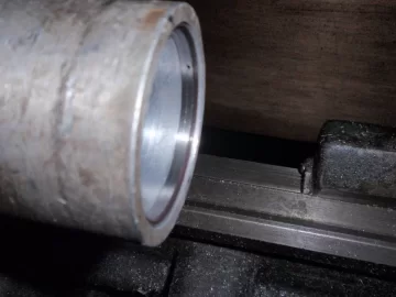

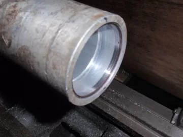

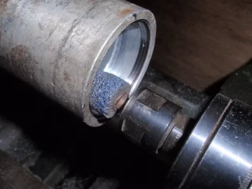

Rings were the right diameter with the correct thickness for piston grooves, but they were too wide (piston grooves weren't deep enough.
I am fortunate enough to have a lathe and decided to grind the inside surface of rings. Could have just ground by hand but decided to do it right.
