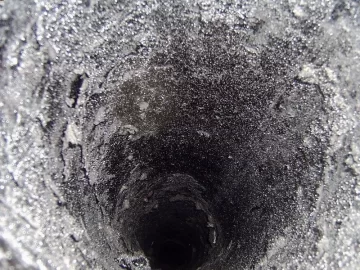

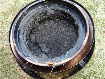

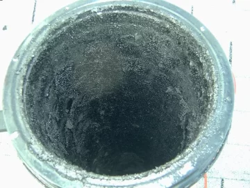

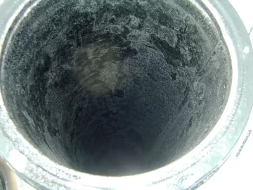

Well guys, my chimney was pretty bad. I've been burning with an older Buck 27000, and man is this thing dirty. I've been burning since october and this is how things looked. I used my Sooteater today to clean it out. It seems to work pretty good.
What are your guys' thoughts?
The one on the left is before clean, right is after clean.

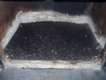

This is what was in the stove after I was done. Seems like a lot to me but I'm a rook.

Well I guess because it is shot at a different angle. I should have tried to get that angle when it was clean for a better comparison. I only have 13 feet from stove top to chimney top and I had a good pile of creosote so I know it got a lot out of the chimney. I'm pleased and when I fired the stove up and I opened it wide open to the point where it used to make the stove pipe start crackling with the creosote catching fire and I had none of this so I'm pretty confident about how clean it got it.

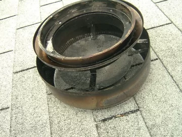

Glad to hear it looked like normal use nobody has commented on that yet and I was wondering. The cap is bad huh?
