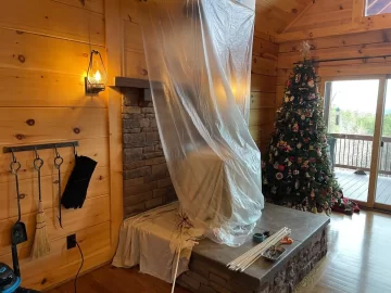

We used the soot eater with the white rods. No issues what so ever. We did bottom up cleaning. We hung painters plastic around the stove, used old sheet on hearth and over stove and then used a kitchen garbage bag around the pipe attached with rubber band and left a small section open which we stuck the soot eater through. Very little mess.
