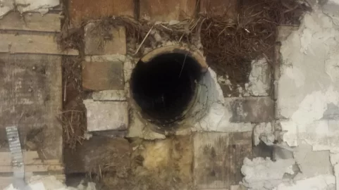

Being skeptical of everything in this house. We decided to rip out the hearth and chimney that my wife had been burning with for 5 years.
Photos are elsewhere on here, but long and short of it, there was a clear crack in the thimble that led directly to dry hay and leaves packed directly against it by squirrels prior to her moving in. There was actually evidence of scorched hay against the thimble in the wall.
How it didn't burn the house down is beyond me. Very thankful we re did it this year and now know it is all good.

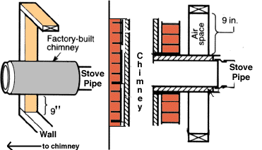

There's supposed to be masonry surrounding that thimble and your stove pipe should always project inside to the flue so the thimble is subjected to heat but not actual fire.
Yes, there needs to be 12" of masonry to the nearest combustible including the wood framing. However, the flue pipe should not project into the chimney. It should be flush with the inside liner.

As far s the original posters concern, if the wood stove was the cause of the fire it was probably due to either an improper installation that was against code, lack of proper maintenance, or operator error. As long as your equipment is setup properly and to code, and you maintain and run it safely you shouldn't have to worry. If you do have any concerns about your setup, have it inspected by a reputable certified sweep.
Yep. It's the wife's house. She had a stove going here before we got together. Got me to buy a stove and install it in my house in NH after seeing how nice the heat from it was. During my install, I found Hearth.com and learned a TON of info, and continue to learn.
As time went on and I started doing projects on the circa 1850 house, as a contractor, I started to see how many corners were cut by previous owners. Bad electrical, bad plumbing, bad carpentry, you name it, they found a way to do it wrong. That, combined with my new found knowledge on here over the past couple years, and her dislike for the brick hearth, is what prompted me to dig into things and take a look around.
It was sleeved with stove pipe on the inside, but hadn't always been, the mortar was gone around most of it, the debris by the crack was charred, but appeared to have snuffed itself out due to a lack of oxygen, maybe from due to the fiberglass insulation that was also stuffed in where the mortar was missing.
She always swept the flue herself so a pro never laid eyes on it, scary.
Long and short, this is what I think of when people say they don't understand how a stove can burn a house down.
Yes there should be but I rarely see it done correctly From what i have seen chimney fires that start house fires usually either start at the wall pass thru or just from heat transfer to wood that has gone through pyrolysis for many years and with this fire it got hot enough to ignite. That is why i always stress the importance of insulation.
