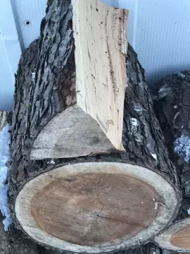

Okay and just for the sake of sanity can someone please confirm that this is indeed black cherry and not a mature black birch?

Big beautiful black cherry
Definitely cherry.
