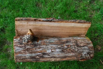

WOODBUTCHER said:
White Oak, even saying its name curls my face like a pirate.....Arrrrggghhhh !
WHITE OAK, WHITE OAK, WHITE OAK...ok, let's see a pic, butcher. :lol: Rick
  • [Hearth.com] split oak measures around 16% moisture
