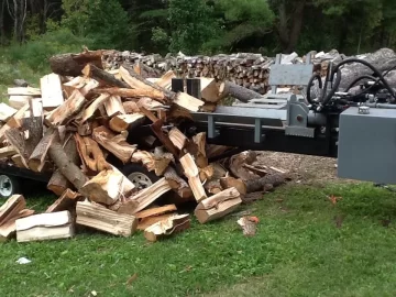

It took me a few years to realize it but the best setup for my situation is a splitter with a log lift, wedge on beam, thin style wedge to slice through knots and an adjustable four way. And of course an auto cycle valve. I also went with a 36" stroke so I can split two rounds at once.

Those are some good points. That also looks like a sweet splitter. I don't see any markings on it. Is it a custom build?

I built that splitter. My father helps split sometimes. With my first h/v splitter I could cut the logs to length, bring them to the splitter and stack the splits while he ran the splitter. Now I have to work harder to just to keep him supplied with rounds to split...
