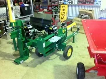

I have noticed more and more splitters, presumeably from China, have the design whereby the cylinder is not supported on both ends. Like in the attached photo.
I cannnot remember what those pivot points are called on the side of the cylinder but recall seeing an older post where these would shear off and cause fluid leaks.
Should I ignore all splitters which are not supported on both ends or have the designs improved over time?

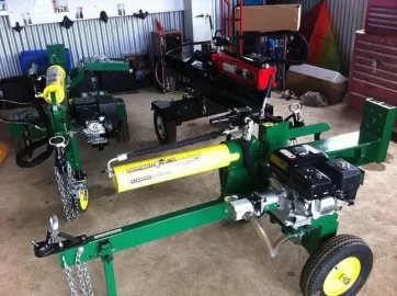

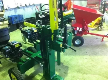

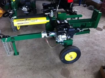

What type of mount would this be? I don't see any mounting points welded to the cylinder. It appears to be clamped in place. What is your opinion on this? This splitter is for sale here and the price seems too good to be true, which normally is..
Here is the advert too:
new log splitter 28 ton
6.5 hp petrol engine
split grey box, red gum, sugar gum, swamp gum, etc
vertical or horizontal
13 second cycle time
split logs 61cm long
compact design
hard steel 18cm wedge
auto return valve
50mm tow ball coupling
we also deliver within South Africa and neighboring countries too

Trunion
