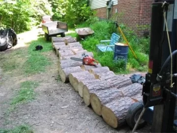

Try to make the row of rounds parallel and about 8' away from where you want to stack the firewood. That way the wood falls off the splitter right about where you want to stack.
Put the smaller rounds on the bottom of the pile and the bigger rounds on top. That way you don't get tired as fast moving the big rounds to the splitter.
Make sure your chainsaw is ready to trim the odd round to length.
And if possible rent a splitter with a four way wedge.
Personally, with this setup, I don't find it any faster to have a second person helping. A second person just gets in my way. All I have to do is turn around, grab a round, cycle the splitter and repeat. By the time the splits get to high on the back side of the splitter it's time to pull ahead a few feet so your not having to take more than one step to get to the next round. I come back later to stack. With 12-14" rounds and a four way you can do more than 1/2 cord an hour.
Line'em up and rock and roll.

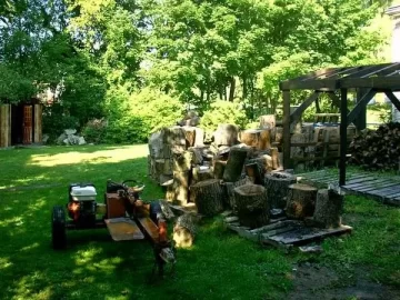

In a full day I split 12 full cords with a rental splitter, working steadily by myself.
Don't worry about stacking your splits while you have the rental, do that after you return it.
Get the rounds laid out or in reasonable size piles where you can toss the splits right at the end of the splitter and wheel the splitter to the next pile or just down the line when you run out of rounds.

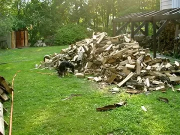

This is what I split by myself in one day.
