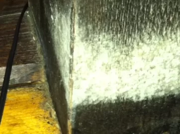

We had spray foam installed in the rim joists and between the floor joists above the crawl spaces in our Cape house last Fall. The original house was built in 1758 but the problem appears to be in the 1970's addition.
I was picking up kid toy clutter and moved a box of toys by one of the fake antique beams in the room, and found this (see pic). It's gray and fuzzy.
The only thing that we've changed in the house since last year is the insulation. The first winter/summer we were here, we saw no mold. No idea about the hard line at the bottom - there was nothing against the beam, just a toy box (no mold) near the wall.
Thoughts? Help?

Not sure if it is related to the spray foam or not. Could it be coincidental? This looks like moisture accumulating at the base. Is the fake beam open on the bottom to the point where cool air from the crawlspace can get up in it? Or is it possible that moisture is leaking from above into it?

Its a little hard from the photo and description to tell what's going on.
Is it possible that water is getting into that wall/beam from above?
My thought is that the insulation from below is acting as a dam and that water that might have been leaking through to the crawl space before is collecting inside the wall/beam.
Any chance to post a photo that zoomed out far enough to see what's going on there? That photo reminds me of those old National Geographic (?) articles with close-up photos of familiar objects. ==c

If this is a false beam I would uncover it (wearing a mask so as to not breath in mold spores) and remove the covering. You need to investigate where the moisture is coming from. Don't delay, black mold can lead to nasty long term allergies.
Is the rim in this are well above grade outside, or close to grade? Is the foundation outside 'wet'? Might be a capillary issue with the foundation?
What does the siding outside the rim look like? Can the rim joist 'dry to the outside' through the siding?

if this is the area of the bottom plate, upstairs, it could be a little colder than before, because it is no longer being heated from below. If you have high indoor humidity in the winter, and this is the coldest spot in your house interior (shielded behind a toy filled box), then this is a condensation point.
If your winter humidity is too high, you will get condensation somewhere, windows, the random cold corner, baseboard or crown molding. Buy a hygrometer, clean up the mold, and try to keep the humidity under 30% this winter. And put the toybox on an interior wall.

Hmmm, interesting questions. This is actually a "real" solid wood beam; I refer to it as "fake" because it's intended to match the hand-hewn 18th century exposed beams in the rest of the house but it totally doesn't. It is, however, solid wood. The mold line starts a couple of inches above the floor (?) and is only on the three sides of the beam that are in the 1970's addition. The backside of the beam is in the dining room, part of the original house, and has no mold.

I'm still trying to get a handle on what we're looking at.
You're calling this a "beam" which is a horizontal member.
Perhaps this is really a post which is vertical?
Yes, it's a post, sorry! The mold is near, but not touching, the floor.

What does that post sit on? Does it extend into the crawl space past the foam insulation?
Maybe that end of the post is cold and water is condensing there (someone else may have mentioned this).
That distinct line of growth versus no growth on a solid post is what is throwing me. Perhaps there is some sort of coating on the lower portion preventing mold growth?
If not a condensation issue then I suspect water is accumulating at that end of the post whether its coming from the top and a roof leak or wicking up from the bottom somehow.
Bottom line,FIX THE ROOF. Even if you stop the water from entering that location,its probably coming down inside your walls. Fix the roof,and you wont have to deal with the resulting water everywhere.
