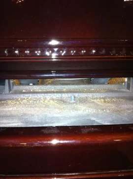

I was just away for a month and noticed some rust! I'm assuming this isn't normal? [Hearth.com] Spring cleaning the stove...required?
Yes it happens, particularly if the weather has been very humid or if the stove is in a damp location like a basement. No big deal unless it gets soaking wet in there.
