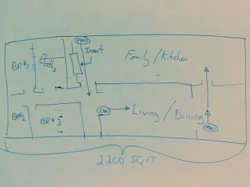

Sketch of Layout Attached
SqFt of Home: 2200
FireplaceX Large Flush Hybrid vs Medium Flush.
Opinions on buying an insert rated to heat 2500SqFt vs one rated at 2000SqFt that will be in a room ~800sqft. The intent is to use insert 24/7 to at best heat the house at a comfortable level, at worst, use furnace part time.
  • House is 2200sqft, room insert is in ~800.
  • Should I be concerned that the ~800sqft family room will get uncomfortably hot?
  • I plan on trying my hardest to move cold air in a convection pattern from familyroom/kitchen to livingroom/dining. Anyone with a similar layout achieve a comfortable airflow?
Let me hear your thoughts on this. Thanks!

Have you considered getting a fireplace with a ducted heat option? I'm wondering if the return air could pull from the other areas.
Is there a basement or crawlspace?
For a convection loop only one fan on the floor running on low speed would be necessary. The far right fan would work well for this.

Thanks for the reply! There is a basement. I have thought of how I could modify the house, years down the line, but I'd like opinions on what I am currently working with.
Fan location noted.
If you are putting in a new fireplace then ducting it makes the most sense. It will be quieter and more convenient. A small return at the end of the hallway and in the dining area would suffice. It would be difficult to retrofit this unless rear access to the fireplace is excellent.
Fan location noted.
Pre-existing fireplace, inside the house envelope.
My bad, I glossed over the insert and had new FPX fireplace on the mind. With decent convection you can heat the whole place. Both inserts will do the job, but the larger insert will give you longer burn times. For Illinois I would lean toward the larger insert.
In the future convection can be improved by running insulated ducting in the basement with a quiet inline fan, but for now try one between the dining and family room. that will create a circular flow. It won't help the far bedrooms much, but at least you will be heating a larger area of 1600? sq ft.
