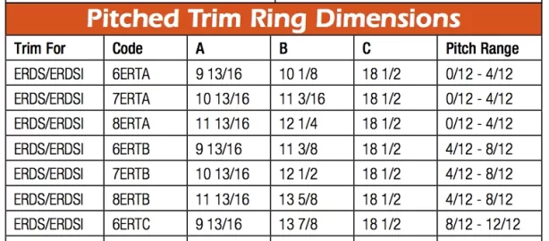

I appreciate the input. Seems like the trim ring for a round support box on a cathedral ceiling would be shaped elliptical...and of course the hole in the drywall -- I can see why the square box is so popular as this would be a little difficult. But worth it in my opinion...does anyone know if Excel sells the trim rings for cathedral ceilings?
You are correct. The trim ring would be oval. You need to choose the trim ring based on the slope of the roof.
