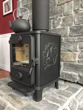

I finished this back in October, but never had a chance to post the end result. If you were on the forum in May or June, you may have seen my plans and questions I had.

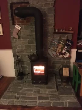

Well here’s the end result, and I’m so happy with it. Turns out that this little squirrel WILL heat the house in 0 degree weather, provided I have enough wood to keep it cranking and close some doors upstairs in rooms not being used. So we could weather a long power outage and probably even keep the pipes from freezing in our little house.
I didn’t have enough wood this year, only enough to supplement heat - which is really all I wanted it for (and emergencies).
Thanks for all the help and info regarding heat shield and pad construction. I really learned a lot doing this.
And note, those stockings in that picture are just there for the photo - we took them down when the stove was in use.

Beautiful! That's a mighty throne for the little guy.
Sharp looking hearth.

Burn time depends on the type of wood. Maybe 4 hours with oak. It’s not an overnight burner unless you rig it up with coal grates for anthracite maybe. I haven’t tried that yet, but it might leave hot coals in the morning in that case.
Once I get it heated up and all the stone behind it, it throws off plenty of heat for most of the house. But my house is small (1300 sqft) and the stove is in the very center.
I did experiment using it for the only heat supply on a -1 degree day around New Years, and it kept most of the house around 65 if I closed off 2 of the bedrooms upstairs.
For ambiance and comfort you should be fine. I’ve had guests comment on just how much heat this little stove can put out. But you’ll have to cut your wood small. 10” is ideal, 11” will still fit, up to 12.5” will go diagonal.

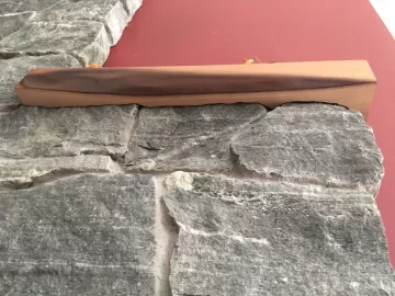

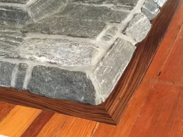

Beautiful masonry work ! Really like split level chamfered stone work, and wood trim along the floor, and custom mantel. Looks like a real labor of love.

Thanks! My mason friend gave me some tips. Had to make sure it was something I’d be happy with for the next 20 years.

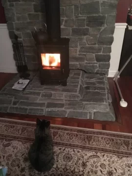

I love the cat looking at the stove.
