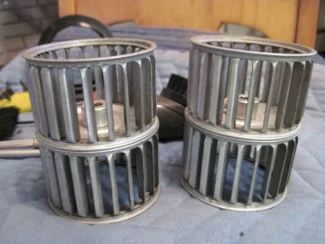

Just for reference, these are my room blowers, made of metal. It doesn't show well in the photo, but the concave part of each vane is packed solid. I had to scrape the dirt out, then wash the cages. This is how the stove was sold to me (used). I got much more airflow after the cleaning. I clean them every year, and get nowhere near the dirt. Guess they were never cleaned before!

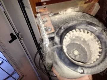

so your fan had a little dirt? Check this picture out:)[Hearth.com] St.Croix fan
I'm new to pellet stoves, but the nastiness of that fan doesn't surprise me at all. Since you're all computer users, try taking a look inside there someday, especially if you have a desktop that sits on the floor!

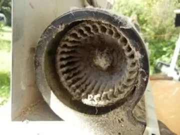

This was ours after a season[Hearth.com] St.Croix fan
