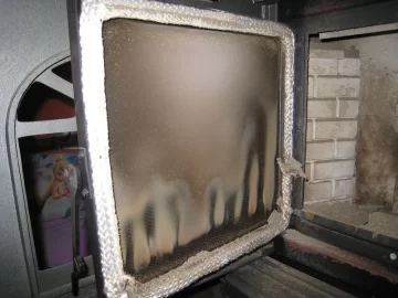

Thanks guys, attached is a pic of the pattern i'm curious about.

Looks like the airwash os plugged with dust bunnies (or the like). I use a lighter and run it across my airwash once a month. The flame gets sucked in by the air and then burns up any dust or foreign matter.

I was not the 1st to mention "Airwash". Smokey did awhile ago..
The airwash is a small gap that pulls air around the window, or in other stoves, through a channel and across the glass to keep it clean.
With glass that looks like that, you either have a plugged airwash, or a plugged stove (dirty)
Smokey beat me while I was typing. He is VERY thorough. And knows what he is talking about.
Have you ever tried running a lighter across the bottom of the glass?? Maybe there is no airwash?
I thought I have fixed my dirty stove with the leaf blower trick. My flame definitely looks better than it did before I did the leaf blower trick when I was getting black soot after a night of burning. I've been going a couple of days on lower speed before getting the glass dirty. Way better than before the blower. So if it is a dirty stove, I have no idea where it can be dirty from considering I've cleaned this thing as best as I can. Would a bad rope gasket cause this also? Or am I looking in the wrong spot?

If you put a lighter (or match) flame near the bottom of the glass while the stove is running, if it has a bottom glass airwash system, the flame will get sucked toward the glass.

I just tried that and didn't notice anything that would make me thing there's an airwash system.
