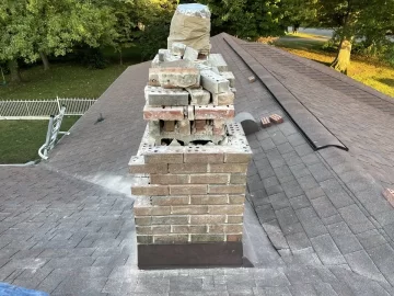

Well this has gotten interesting. I was finally starting to make some headway, and working on removing cracked bricks, and the ones around kept breaking or coming loose, and the faces of 2 brick just popped off while drilling through the mortar to get them out. In some places, the mortar was damp and more fine than others.
Company came and installed the new liner last week, but it's still not connected to the stove yet. The angle it comes through the flue opening won't let it seat into the collar without forcing it. At least this time they agreed that an elbow would work better, so now waiting on that. At this rate we may be burning by Christmas.

Yeah it is always way worse than you think once you start digging into it. Do you have matching brick?
It's close but not exact. It also looks like they sprayed some type of sealant on the brick in the past, and it has a light sheen to it, so that doesn't help.
Since I've had to take so much down already, I was considering just going ahead and taking it all down to the 4th course and build it back straight up instead of having the 3rd course set in. I'm just not sure I want to risk losing more brick, or time.

Its odd how some chimneys like yours are built by completely filling in the hollow spaces with cinder block and bricks, and others like mine are just a giant shell of bricks with nothing but air around the clay liners.
You can pour the crown on top of solid masonry, which is great. Mine needed steel bars to support cinder blocks which then got poured on top. I like your construction much better.
