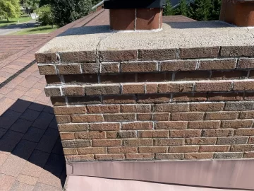

Here are some pics of the chimney. House was built in 1965, so don't know if this would all be original crown or not. Roof and flashing were redone about 6 years ago, and we've been in it just over 2 years. If it wasn't for a cracked sinking patio that needs attention as well, we could do either as estimated, but in order to do both, I'll need to do some things myself. Oh, only one flue is active, the other is filled in.
All the quotes included pressure washing, crown seal, repointing (doing mortar joint on cracked bricks, or replace but won't match), waterproofing, and re-caulking flashing.
My one concern with the SS chase cover is the size of the skirt needed. My concerns on first thoughts of redoing the crown with a poured crown are possibly dislodging/damaging the top row of brick, or damaging the flue liners.

You will without a doubt end up relaying some brick no way around that. You also need quite a bit of repointing done. I would repoint the whole thing honestly. If you damage the tile just replace them
I had mentioned repointing the whole thing to one of the estimators, but they said only parts needed to be done. Seems like it would look better if all of it was done. You make it sound so easy, that there's a big part of me that's ready to get my hands dirty with all of it, but knowing me, nothing ends up being as easy at it seems. That's why I was considering the chase cover route. Hire someone to repoint, and install the cover myself. Less room for error, unless I measure wrong for the cover. But, the poured crown looks a whole lot better.

I am a commercial masonry contractor. My guys make a killing repairing chimney crowns on weekends. Knowing what I know about the performance of mortar and concrete in a horizontal unreinforced application as well as the way that brick and concrete's expansion properties are in opposition to one another I wanted nothing to do with that on my own house when I installed my insert. I used a stainless chase cover and I would never do it any other way on my own house.
That being said if I were to install your chimney crown i would first dig out all the bad joints and retuck with pointing mortar. That projected fourth course from the top is an extremely common and extremely terrible detail. I had something similar on mine. I installed a 45 degree mortar wash on top of mine so that it would shed water and snow. Whenever you work with new mortar on existing work it is always a good idea to dampen the existing masonry to encourage a strong bond. An additional bonding agent doesn't hurt either. I cut my clay liner flush and after all repairs to the masonry are complete give it a thorough soaking with a strong mixture of siloxane (a breathable waterproof masonry sealant that should last at least 15 years). My house has a pourous southern brick, the type a mason hates to lay because they have to joint their work after every couple of brick. I may skip the sealer on a high quality brick out of northern Ohio. If you are certain that you will have no future use for the second flue I would cut it flush and spring a piece of hardware cloth into it and seal it off to the top with a few solid brick and slick off the top and seal it from the bottom as well.
I would order a chase cover with only one hole for the flue in use and make sure it is pitched in all directions away from said hole. Make the opening 3/4" bigger than the outside diameter of the liner. The extra cost for heavier guage was well worth it in my opinion. Mine was well made even though it was slightly "sprung". That was easily corrected during the install which involved shims and tap cons on the 4 sides of the chimney through the four inch skirt which with the flared drip edge sends water far down the masonry prior to contact in most circumstances.
The kit I bought from Rockford had a very nice termination peice for the top of the liner that slid up inside a slightly domed top plate that was designed to be tap conned into the masonry crown. I screwed this top plate down to the chase cover with short stainless self tappers with neoprene washers. I tightened everything together in a very generous bed of silicone. Finally the rain cap slid over the top plate so that everything "shingled" properly.
Realistically, this crown should outlast the stove and the liner and the next one and the next liner after that. The way I installed it I should never have to address any maintenance beyond a little scraping away and reapplying silicone on the stainless self tappers every ten years or so. Even that is a fail safe considering there are neoprene washers at play as well as an intact mortar crown below.
304 stainless is wonderful stuff. I have drums of anchors made of it from old jobs sitting in the woods behind my shop from 25 years ago and the rust stains from the drums can be wiped off with a paper towel and they look like we took delivery of them yesterday. Short of a salt water application I would assume it will outlast any of us and our grandkids.
This is merely my best idea to future proof a chimney crown for an extremely low cost.
