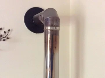

However now my husband is wondering why the upper part of our double wall stainless steel stove pipe ( the one that is connected to the stove not the one outside) discolored last winter,could it have gotten too hot?
Isn't it seperated with an airgap as well since it's a double pipe?

To clarify-it's the pipe on the inside connected to the stove.
OK, that is connector or stove pipe, not chimney pipe. Are you certain this is double-wall? Do you know the brand of this pipe? Is it Durablack stainless?
After further questioning my husband he said that yes it's singel wall ;-) I guess that's what I get for asking him questions while he's watching a movie...and yes it's Durablack stainless :-) Can the discoloration be removed somehow?
I'm not sure it can be removed. That is from the pipe getting hot. You could try a polish used to remove bluing from motorcycle pipes. http://www.amazon.com/Chrome-Exhaust-Polish-Removes-Bluing/dp/B00FNP3YBE
Also, it looks like the pipe may be installed upside down. Hard to tell from the picture. The male end of the pipe is supposed to be on the bottom end, pointing toward the stove.
