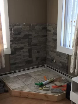

It's getting there all cords will be moved to other outlet behind the tv
Going to need some help moving this thing

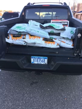

Stocking up on pellets

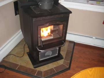

[Hearth.com] Start of my pellet stove
  • [Hearth.com] Start of my pellet stove
looks good so far..
should have built my own but too lazy..lol
paid a few bucks for this one
I really like that hearth pad, and leaves an intact floor if it ever gets taken up.
can you tell me where you got it?
Lookin great
It's getting there
Wife is really happy so far lol
Temps are drop here in New York should be running by Friday can't wait
Sent from my iPad using Tapatalk
Try as many different pellets as you can and see what burns best for your set up.
