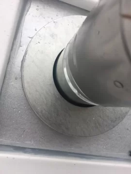

I am installing a wall thimble
Cut the hole in the wall do I put insulation around the thimble that sit in the wall ?
Or do I leave I air gap in the wall ?

Insulation, use roxul as it doesn't burn. You never want un insulated voids left in outside walls in a cold climate its a recipe for mold and condensation. Also seal the thimble plates inside and out well.

The data sheet on that product indicated it will burn if exposed to open flame or sparks. Now if there was open flame or sparks outside the thimble you got bigger problems anyhow. Not sure how to advise about using this. Personally I would go with the Roxul.

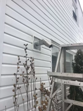

Any tricks for the thimble
Mounting on the outside
I have vinyl siding and was going to cut it and install j channel to make it look nice
That's how mine is; J channel around the thimble, sealed w/ silicone. What stove do you have?

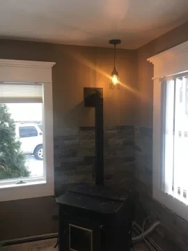

Pipe placed where it will sit

My thimble came with a gasket. Since that is too old now, used numerous wraps of the high temp silicone tape to close off the opening. I didn't want to use RTV as I didn't want that much difficulty if I need to pull it.

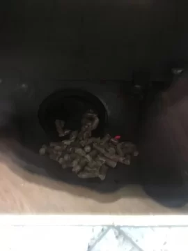

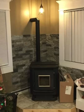

Ok here we go
All turned out well

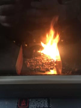

Fired it up
