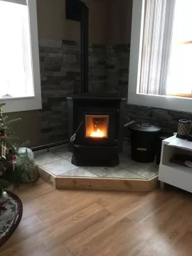

Any real way to test the flue leaks ?

At night when it is dark just turn off the lights in there and use a flashlight to check. Any leaks you will see. Plus even with small ones you will smell it, especially on startup. I had several pin leaks with mine back there and I was able to find them.
The oil/paint smell should go away after a few hours. Try running the stove hot for awhile with some windows open and that will cure most of it in short order.
I really like how you ran your pipe up on the inside then out, looks better outside and you will get a bit more heat inside as that pipe can get quite warm. If I had to do it over I would have done that with mine.
I used the pellet vent pro pipe
With the orings I don't think I have any leaks just wanted to make sure

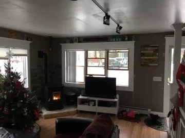

I am really happy the way it came out
Worked out nice
I guess I did it right the house is not on fire yet lol
Looks like a good install, you shouldn't have to worry even leaving it on and going to bed. Only issue I can possibly see is the heat will dry out that Christmas tree faster which will make a mess with fallen needles.

I was the same way with mine but now that I have been using it and know what it will and will not do it doesn't bother me anymore. I do inspect it regularly even the outside pipe but there has been no issues. These things are designed to be safe. Only issue I know of ever happening is creosote buildup from extended dirty burns/poor operation but that is rare and those pipes are designed to take the heat of a chimney fire which would ruin them but they will take it. That is the purpose of that thimble as well. Without the thimble if there was a fire in the pipe it could ignite the wall.
Took all the black pipe apart again and sealed with black rtv
I know they have orings but makes me feel better
Letting dry and test for leaks tonight
You could have used high temp silicone tape on the seams ... that way you can get it apart easier for cleaning.
Looks good enjoy the heat!
All sealed
Fired up checked with flashlight and candle
I think I can rest now
