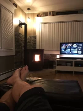

Start of my pellet stove

All is great with the stove
Going to leave it on tonight for the first time
Any recommendations on Settings?
Settings during the day speed fan six feed 5 keeps the house around 73
trial and error on the settings, on nights it's not real cold you could probably keep those settings, on colder nights you may have to bump up those settings. gotta try it out and find what works best.Or hook it up to a thermostat and use the higher settings then when it reaches temp. it will idle down.

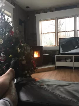

Ok stove was left on all night
Didn't sleep one bit lol
Still getting some black on the glass
I think the door gasket is leaking
Will test tomorrow
