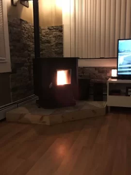

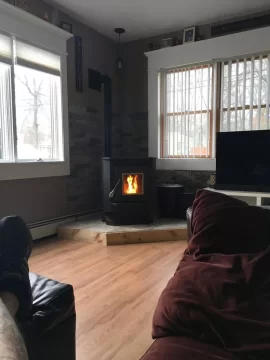

Little update
Dealing with the glass turning black in a day or two of running
Other than that it's working perfect
Keeps the house nice and warm
Any ideas on the black glass problem ?
The flame is looking a lot better
It's full and going to the top
Maybe I had a leak ?
Installed new window glass gasket
Adjusted the door and the pellet storage door
Cleaned all blowers and oiled all bearings
Flame looks a lot better and I am not smelling the smoke smell on start
It was very faint before and now nothing
Maybe there was a leak ?

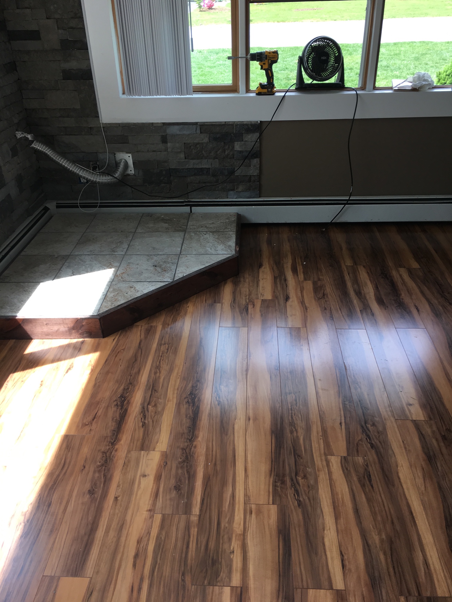

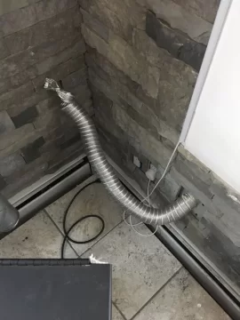

The OAK we have came from the manufacturer. The only difference looks like ours is black so it matches the stove and pipe and it has a flange made for it. I'm sure you can make some kind of cool flange and paint the hose black. Outside ours has a box it attaches to with slots for air intake. i thought that would be great to keep birds out but not bugs so I cut a piece of stainless steel screen and put it inside the box.So the heating season is coming to the end
So sad I really enjoyed the stove
But now it's time to make it better
Any ideas on upgrading the fresh air in take??
This is what I got now
Here ya go. Made me dust back there though.Please do when you get a minute
