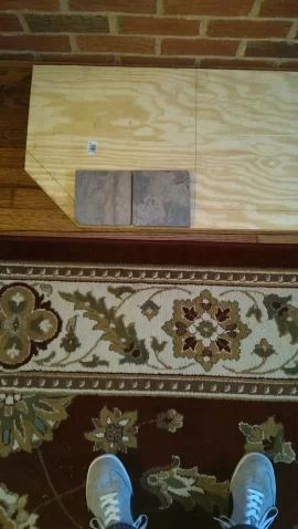

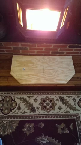

Ok, it's really not a pad as I have an insert, but directly below the front of the stove is wood floor which has always bothered me. That and the manual calls for a minimum of 6" of non combustible material out from the front of the stove. Anyway, not going nuts, just some 6" square slate tile. The base is 3/4" plywood, I'll put some durock or wonder board on top of that and then tile. Before grouting I'll trim it with some sort of trim, probably oak and either paint it matte black or stain in the floor color. Overall dimensions are 36" X 18"
  • [Hearth.com] Started making a hearth 'pad'

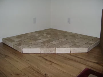

I made mine with 2x2 framework covered with ply and backer board then tiled with 4x4 stone. When I got my stove I looked around for a hearth and about fell out over the price of them. I made this one for under 50 bucks.
Reactions: Ranger72
Looks great!

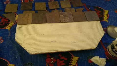

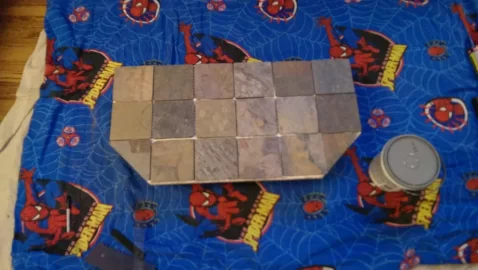

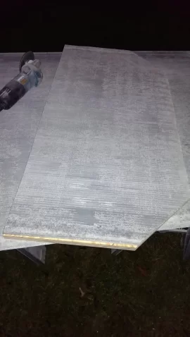

Spare time has evaded me recently. Finally had an hour or so this evening to dabble.
[Hearth.com] Started making a hearth 'pad' [Hearth.com] Started making a hearth 'pad' [Hearth.com] Started making a hearth 'pad'
Reactions: funflyer
Just need to figure out how I want to trim the sides out, then grout and seal.
Nice, As a tile setter for 30 plus years. When you set your backer board to ply it needs to be thinset to the wood. When setting a natural stone , again needs thinset, not an organic adhesive. Being it is a hearth pad all should be ok because there will never be a traffic pattern run on it, yet there still is a chance for failure. Give it one coat of seal before you grout. On natural I always lay out the slate, stone and seal and then set. Then grout. Let dry 24 hours and seal the whole job again.

Thanks for info! I am a painter by trade, first time messing with stone/ tile. I know your supposed to thinset the backer board to the ply, but figured since it's getting zero foot traffic, I went fast and easy and used a more than fair share of PL and some screws. I thought about bull nose for the edges, but think I'll like the wood better.
Wood will be fine, only difference is find a matching caulk color because the grout will eventually crack out between the slate and wood.
