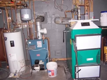

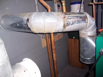

well I started the install for a barometric damper on my eko 25 . I picked up a 8 inch T pipe and a 8 inch plug and ordered the 8 inch barometric damperin T pipe . I am putting it under the boilers flue like is pictured on the site. I was able to reuse my old 8 inch pipe had to cut 2 inches off of one strait pipe so I am ready to go as soon as the damper arrives. I am oalso ordering my new door gasket tomorow so hopefully by next weekend I will be all ready for this years heating season. Also had my second truck load of log length wood delivered that I have to get sawing on. 6-8 cord per truck load boat load of work but eworth it everytime the oil truck drives by the house and doesnt stop. Thanks to this site I am deffintily much more knowledgable about my boiler you guys are the best pics coming soon!

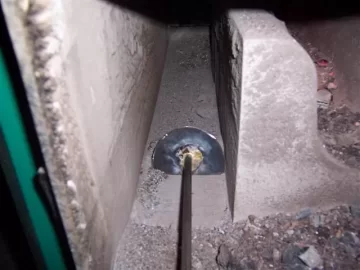

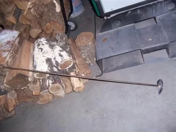

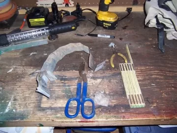

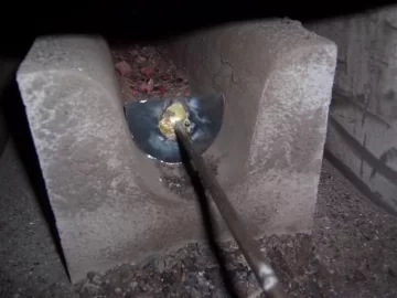

here are some pictures of the new flue setup also couple of pics of the ash tool I made at work from ideas I got on here! Sorry the pipe is not all nice and shiny. I left it out side during some the rain before cleaning it. but hey it still works :-)
