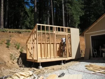

Started my new wood shed today
nshif
Tired of not having enough wood under cover so adding some storeage space. will post more as we progress

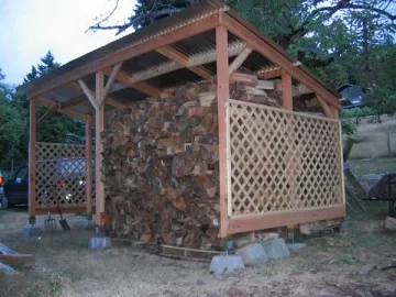

I had the same requirements for good looks, but also wanted it to breathe. Found a stout lattice that solved both parameters.

Looks good. Like the raised bottoms on the sides for air. I'm definately going with the lean-to type shed. I will be loading into the bucket of my tractor for transport to the house so I need good access. Those completely inclosed sheds seem like a lot of extra carrying work.
Very sweet BG--but that front row looks very high, can you get to it without a ladder :lol:
I didn't mention that I'm 7'2"?

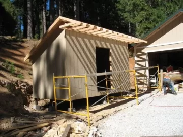

Heres a recent pic, there are vents all around the evev and the floor has 1" holes drilled in it for aor air bur my wood stays out in the sun all summer which here in Ca with no humidity gets it pretty dry in a few months. most of the wood going in the shed will be 1 year seasoned.
He also forgot to mention that is wide ;) UGG UGG
Nice.. might need steps or a ramp in the front. More than enough room to split wood in if needed..
Very nice looking shed. Looks like you put quite a bit of thought into it. Any idea what it's going to do to your property taxes? I used to live in Carson City and while I never owned property there, I knew people up around the lake that did and I couldn't imagine paying their property tax bills.

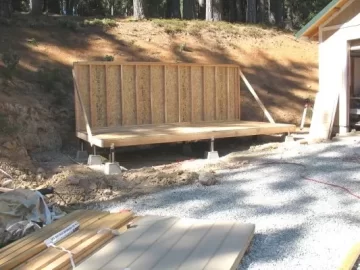

Every city has different rules, in my case no building permit (no tax implication) is required for structures under 120 sq ft. I think my shed is 115 sq ft and will hold close to 5 cords- more than enough for one winter. Mines almost the splitting image of BeGreen's except mine has a regular wood/shingled roof. I'll add a pic later today.

Mines almost the splitting image of BeGreen's...
So to speak... %-P Rick
Excellent looking shed! Not knowing if you have these problems out there like I do in NH, you may want to put down some small grid wire on the underside of the floor (if you can still get to it) to prevent mice and other rodents from climbing up and in to the wood shed and making nests... 1" holes are pretty big and would allow them to get in there. Just trying to be helpful!

5 cords can be up to 25,000lbs or about the weight of an empty tractor trailer. I think I would support it every 4' under neath if you plan on filling with wood.
Good point. Mine has no floor, it is just pallets placed directly on the ground.
Dont really have a rodent prob here the snakes take care of them
2 cords of the wood stored in there will be Cedar or Doug Fir which dry doesnt even weigh 2k a cord. the rest (3 cords ) will be hard wood that when dry is about 3k a cord so that keeps me below the design spec of 125# per Sq foot.
