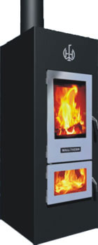

As far as a wood gasifier in the living room, I'd love it if someone who had something like this would write about it:
http://hydro-to-heat-convertor.com/gasification.html
