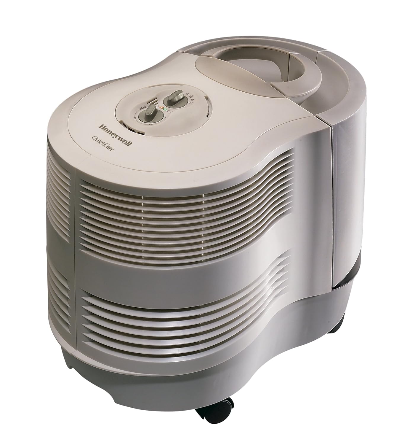

If I had a stove that nice, I'd be using one of these:
[Hearth.com] Steamer for Enameled Stoves Without Griddle
http://www.amazon.com/Honeywell-HCM...TF8&qid=1356140289&sr=8-4&keywords=humidifier
Even on my black finished stove, I stopped using the steamer a few years ago and haven't looked back. The humidifier does a much better job and the stove top doesn't get mucked up. The old steamer I have is pottery with a chimney like top that never boiled over when on a trivet, however, i'd lose a drop from time to time when loading it from my pitcher and that'd track up the stove top.
At the end of the day, no matter what you put on that finish can possibly damage it with movement. Perhaps the least damaging might be a piece of soapstone, then the steamer of your choice on top, however, it still isn't going to provide much moisture.
Just my 2cents.

...What's the best sort of steamer to put on the Oslo?
None. If the intent is to humidify, get a humidifier. If the intent is to give the air a pleasant scent, use potpourri...dry or candle-heated...or scented candles, or whatever. Nothing you can put on top of that beautiful stove can add significant humidity to your home, and it has the potential to dry out & overheat and damage the stove finish. Rick
