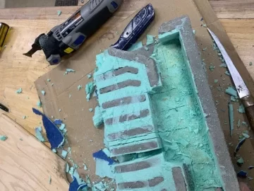

After pricing the stainless and the pretty much negative thoughts I changed directions. I made forms out of polystyrene cut with my cnc machine, bought castable refractory cement, poured it and made a new package to go in the stove. Installed it and so far it is working great.
The people that sell the castable product indicate that is should perform well.
Not sure how it is going to work long term, just have to wait and see.

Good luck. I think it will be to brittle and not last long but I hope I am wrong. The whole downdraft design just sucks in general.
That's a pretty cool rescue. It gets an A+ for creative effort. It's nice to have a CNC machine and the talent to use it well. What castable refractory material was chosen and why?
If this proves durable I'd bet you may here from a few people;lol Rather curious how this holds up. Nice effort.
I also hope you are wrong about it being to brittle. The people at Rutland that manufacture the castable refractory cement are confident that if you follow their instructions it will hold up. Their experience with casting fire brick has been positive in that respect. I will have the answer to that question after using it for a while. I had a jotul stove before and I really liked it, but I sold that house and bought a log cabin and ended up with the resolute acclaim and I have to tell you that if the refraction package was not so sorry, the stove performed well for our needs for the last 12 years, and was very user friendly (top or front loading, easy ash removel pan, and with a full load was 6 to 7 hours burn time, and for our needs has been acceptable. I had replaced one burn package and did not want to replace another as you know they are fairly expensive. If this doesn't hold up well I will likely be hunting for a different stove. steve

RUTLAND Castable Refractory Cement, was the product I used. I ordered it from amazon, but it is also available from local hardware stores. I am also going to cast some fire bricks that will fit my stove as they are looking a little ragged. The stuff works, just like Kwick krete, but it sets up pretty rapidly. The why answer is that I was searching for something that was castable, that would handle the heat and I came across it. I had looked for refractory material that I could easily machine but couldn't source it. steve
I really hope I am as well. I have cast lots of refractory stuff but nothing that will take that amount of heat. I am looking forward to hearing about the durability.
If it doesn't hold up there are much higher quality castable refractory cements out there you could try. They get expensive though.
