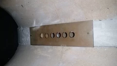

This is my first year for running my eko 25. I made a nozzle cover out of 1/4 inch stainless and drilled 6 one inch holes in it. So far it looks like the day I made it and I get very little coals that fall down and great gasufication. I read a couple people on here made it the same way with great success, that's why I made mine. I think jtwall made a you tube video of one. If your not to far from south west pa I would have no problem making you one and shipping it to you.

T4--why did you decide to go with holes instead of a slot? I'm assuming it was easier to do that way, and it looks like it would work just as well--as you say it does.
Seems like a really nice custom upgrade. My 60 has two nozzles, so I would probably try to get a one-piece unit made that stretches the length of the firebox. Do you think a piece of ss that big would warp?
There was a thread awhile back about holes versus a slot and they said holes worked better for keeping the coals in the top chamber. As far as trying to put a plate across both nozzles, I would make two separate plates. I would think it would warp if one nozzle had good gasification and the other one wasn't going as good. There would be different temperature I would think. I have the 25 so I'm not sure how they run. The only problem I have with the homes is when I'm starting a fire if the holes are covered with coles it won't let enough air in to get the fire going then it gets a big puff of smoke and flames when air finally gets through. So I have just been making sure the holes are not blocked when I start a fire.
