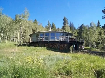

I'm planning to replace my Fisher; probably sooner than later after all I've read at Hearth.com about newer stoves. From what I've read here, a new, smaller stove could cut my consumption nearly in half; to about $350 per year. I live in a harsh environment with my only fuel sources being yellow pine, Douglas fir and aspen. My house is small and round with a center peak roof about 13' high. The kitchen/great room is about 500 sq ft and the two bedrooms and bath take the other 400 sq ft. Since the house is round and the stove is near the center and all the rooms have doors the directly face the stove, the whole place heats rather nicely and evenly. Since this is a single story house and the stove is on a pedestal, the chimney is only about 10' tall to get it 4' above the peak. I have no back up heating options but my house has full southern exposure with a panoramic view that lets in maximum winter sun so even on the coldest day, like today 7 degrees for a projected high temp with wind gusting to 80MPH, it is HOT in here with the stove shut down to embers.

Nice place. I like round homes.

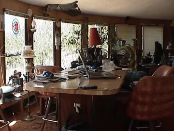

We talked about taking the stove out of the house but decided it belongs in the center of the room. However, with a new stove and a reduced clearance requirement, I could move the stove enough to put in a pool table. Hmm....I'll bet there would a a couple shots that would really burn my butt though.

VERY nice place, btw.

Nice place, by the way. I would have to build another smaller circle to the side, just for the hot tube with panoramic view. :cheese:
