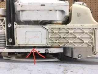

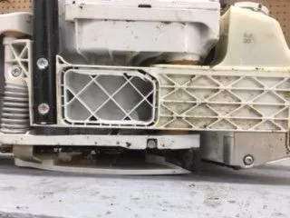

One photo shows the plastic covering in place that shows how to adjust the screw. After prying off the plate (that wasnt suppposed to come off as I had to tear it off) there isnt anything under the plate either

What is that screw just ::DT in the square notch out?
Not sure, but if I "unscrew it" it backs out. It holds something in place. It has an allen head.
When i get home i will take a picture. Its by the cover you took off. You dont go straight into it. You have to angle your screwdriver into it.
