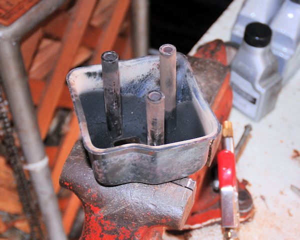

    A hollow cylinder in the muffler...... could be the tube that the bolt passes through. Will one of the muffler studs fit through it?

    No its in the muffler!! There is no way the rod bearing could get inte muffler. I have pulled the muff;off the saw and its in there. Like I said it looks like it could be 1/2 long by maybe 1/4 thick. I can see it through the hole that the mounting bolts go through. I ran a tank through the saw today. If it was rod bearings it would of grenades by now.

    I can't tell if its hollow? But look; at the size I bet a bolt could go through it?

    Does it look like one of these?
    [​IMG]
    This would be my solution. ;)

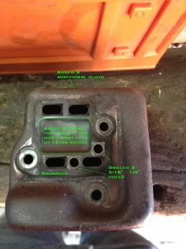

    Note that if it is indeed the inner guide tube for the bolts, then the muffler will not torque down/seal properly. I would replace it before too long. If you get an original muffler (new or used) I would modify it for better flow for sure. Poor MS390 is one of the most choked up factory mufflers I've seen. Note that the muffler I linked to on ebay (above) already has 2 additional slots in the muffler.
    Here's what I did to the last MS390 I had in the shop.
    Don't forget to carve open the deflector a bit too, otherwise it becomes the bottleneck.

    Thought about modding it. And also just getting a new muff. I did not mod it as i did not want to have to tune my Carb but I have been into it for other reasons so its not factory set any more anyhow. I'll just take this as a point to do that. I already am missing a stud that I not replaced that was stripped when I pulled saw apart. I do have a replacement though.

    But after re-reading your original post (its kinda confusing), I think MasterMech nailed it. Its most likely a spacer that keeps the muffler from collapsing when you torque down the screws. There's no better.time to mod the muffler while.you have it apart. And tuning a carburetor is easy as pie......don't let that stop you from getting more out of that saw!!

    I actually got a chance to look on ebay at those muffs. I think since i need a new one i may as well buy one of those that already has the extra holes in the muff. They look like the same price as the OE design if i buy a chineese part.
    Should i open up the holes on the example muffler that was linked to on this post or is that enough of an increase to do good? Im guessing that the cover plate on the new one needs to be opened up more if it comes with one, if it does not come with a new one i will grind out my old cover a bit more.

    I don't want to go to big
    I ordered one similar to the link posted. But its from. A us seller and has the cover shield included. Its a few dollars cheaper also. It still has the 2 extra hole in it as well.Wat size should I make the extra holes?

    Hard to do if you don't mess with the depressed rectangular area in the center. The mods that I posted are very conservative. Yields a great running saw that retains the muffler screen (IIRC you're a forester no?) and isn't appreciably louder than stock.
    IIRC I used a 3/16" drill to make those.

    I cant see the pic of your mods, its not coming up for some reason? I can see the pic of the pulled apart muffler were your showing me the shafts that the bolts go through ( and that is what the part i can see in there looks like through the tiny holes). I am a forester, but here on the east coast and in SC In the upstate forest fires are of little concern. This time of year you have to almost try and start a fire with matches and gas and if your successfull its far from a raging inferno, something you can almost run through is the result.

    MasterMech
    Guest 2.
    I fixed the post above.

    Thanks for the picture fix. I see you have put 2 holes additional ontop of the 4 slots. i was thinking the factory only has 2 slots?

    Correct.
