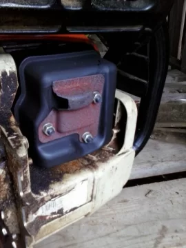

OK i have the new muffler on and modded to look like yours in the pic. and have carved out the deflector plate. and there is no spark arrestor.

All 3 muffler studs back on and new nuts as well. Need to sharpen chain, its cutting Crooked.
Here is a pic of my deflector.This is the original. It came with one but I cut the old one.

Here it is
