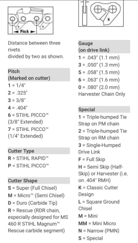

I'm pretty sure the "X" references ripping chain. 63PMX is: Picco (3/8 low pro) M(?) X(ripping grind) and I don't know what the 63 stands for either.
It’s all in the chart above I think. 6 means Stihl pico, 3 is the gage- 0.050”. M means micro or semi chisel.
You got the rest correct PMX — pico micro ripping.

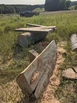

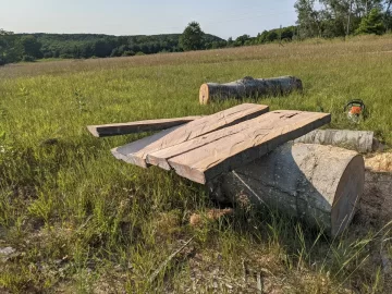

I just went ahead and started with my regular chain… it worked… I learned some things in trying and am sure the next round will be a little prettier. Maybe I’ll know what I’m doing by the time I’m done? Hahaha.
I’ll be doing this all free hand... for a first attempt, I think it turned out alright. Yeah, it could be better… these are maybe 2.5” thick. After drying, I’ll run them through a band saw to get to planks each.
I haul the logs out of the woods with a grapple and very little dirt sticks to the bark of beech. What little there is brushes right off… no need to de-bark.

I should add… I intentionally started on a log that had a split running perpendicular to the cut I was going to make. The wood isn’t as good, but the log was a great one to make “first mistakes” on.
