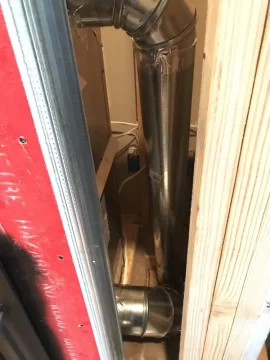

Well, started the demo. I opened the wall on the second floor to the chimney chase. Poorly insulated, no fire stop between floors, old stack touching one of the insulated hvac ducts.. pictures to follow.. glad I have 2 weeks before the install. A lot of corrective work to do. Would have sent the budget through the roof.
Yet another example of a zc fireplace installed incorrectly. We see it way too often.

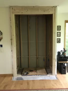

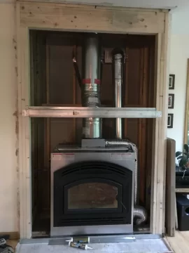

Framing ready for install. Thursday they’ll be here. I have a heavy walnut mantle that I’ll mount with a 3/4 pipe system I’ve designed. More pictures next weekend.

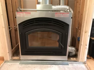

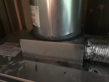

[Hearth.com] Still without new fireplace!! [Hearth.com] Still without new fireplace!! Install was yesterday. Overall a very good installer. I have a question about taping the joints of the chimney air kit. I’ve seen videos of some installer using aluminum tape on the box where is attaches to the chimney. My installer wouldn’t do it. That looks like a real source of cold air into the chase. Has anyone used aluminum tape in this area? Can you share your experience?
View attachment 244598 View attachment 244599 Install was yesterday. Overall a very good installer. I have a question about taping the joints of the chimney air kit. I’ve seen videos of some installer using aluminum tape on the box where is attaches to the chimney. My installer wouldn’t do it. That looks like a real source of cold air into the chase. Has anyone used aluminum tape in this area? Can you share your experience?
The air cooled chimney is a source of cold air that box is just a drop in the bucket. I would bet the installer wouldn't do it because the instructions say not to.
I checked the instructions and they don’t say either way. I’m going to tape the joints. You said “drop in the bucket”. What else am I missing?
Thanks for your input.
Your chimney is air cooled it has constant cool air running through the outside cooling both the exhaust and the surrounding chase.

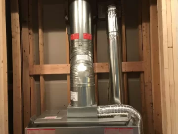

[Hearth.com] Still without new fireplace!! I used a caulk product to seal the outside air kit. Temp up to 1360 degrees F. I am taking my time and reviewing every possible air leak and solution.
I installed the first box header to support the mantel. Another will go below this and then the studs.
I want it done but I’m afraid not to think everything completely through.

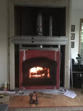

[Hearth.com] Still without new fireplace!! Sorry I am so slow with this. Between all my other projects and fireplace ocd, I am behind the eight ball . First fire. I replaced all of the air intake flex duct with solid. Sealing every joint.
  • [Hearth.com] Still without new fireplace!!
That's a good sized fire, must have been a bit warm in there.
I only filled the firebox 1/2 way. It just took off. It is in the 50's here and we ended up opening the windows and doors!! The smoke alarms went off with the burn off of the oils, etc!! Definitely generated some heat..

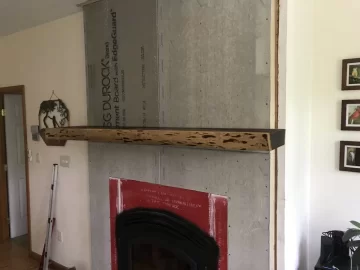

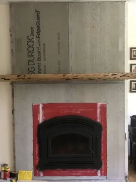

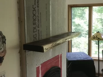

[Hearth.com] Still without new fireplace!! Finally mounted the mantle. I struggled with the epoxy that I used to fill a large check in the end.
I am happy with the result though. Next, the mason.

View attachment 244909 Sorry I am so slow with this. Between all my other projects and fireplace ocd, I am behind the eight ball . First fire. I replaced all of the air intake flex duct with solid. Sealing every joint.
I was going to suggest replacing the OAK flex with rigid, glad I kept reading before I posted. Good decision.
I bet the house was super toasty with that fire, I'm sitting here in A/C and can wait a while till I even think of sparking a flame.

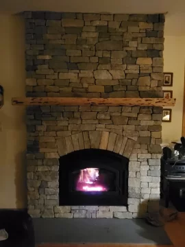

The beauty of doing much yourself, is knowing it is done how you want, and if knowledgeable enough,, or researched and prepared well, you know it is done right, as well as saving some coin.
Looks great, nice work!

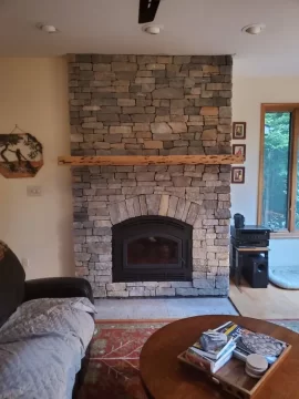

It is very cool here at night, mid to upper 50’s. Northeast PA summer is short. We have outside fires this time of year. This weekend I am installing the hearth and We’ll have a fire right after that.
Looks great!
Beautiful. Many happy burns to you.
