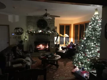

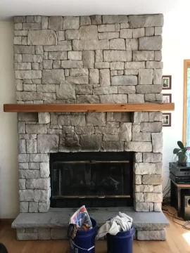

Well, it has been a challenge getting contractors to quote (show up) on replacing our fireplace. We've given up on trying to get a Pacific Energy FP30. No local dealers. I was going to purchase and have it installed but still no one wanted to touch it. We are now looking at the HeatNGlo Northstar and Quadrafire Pioneer 2 models. Both built by the same manufacturer. Northstar seems to have more information on this forum. I like the Pioneer 2 single door for viewing area. Otherwise not much difference. Anything with those units I should be concerned with?
Do you have any RSF dealers in your area?
What is your existing configuration? Pics?
Could be easy, could be very difficult to the point nobody wants the job.
I’m doing the demo and framing. Just need them to install the fireplace, Outside air makeup and chimney. I have a mason that I use for the facade.
Good placement. Nice room.

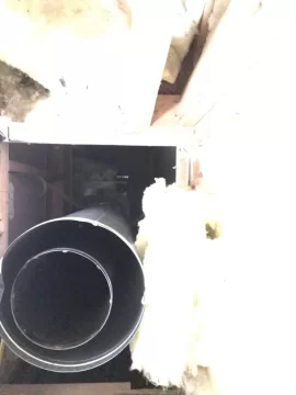

Well, started the demo. I opened the wall on the second floor to the chimney chase. Poorly insulated, no fire stop between floors, old stack touching one of the insulated hvac ducts.. pictures to follow.. glad I have 2 weeks before the install. A lot of corrective work to do. Would have sent the budget through the roof.
