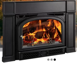

I want to paint the used VC Montpelier I got earlier this summer and get it looking brand new again before installing.
Does anyone know the brand and exact color of black VC uses on the Montpelier?

I am sure it is stove brite paint. Look at it if it has metalic flakes it is metalic black if not it is just flat black. From memory i dont think it is metalic but i am not sure i dont work on to many of them. If the stove has been used you will need to repaint the whole thing anyway so the color doesnt have to be perfect.
From the look of the Montpelier black finish I would say it is more like a Satin Black and not flat.
You may very well be right. I like satin much better when ever i am repainting a whole stove i use satin.
Yes, that is what I did the last stove with too. It looked great.
Thanks guys. Will be going with stove bright satin black then!
