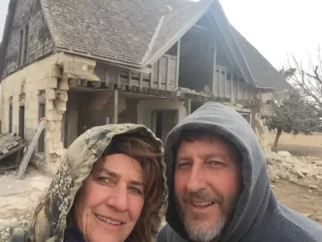

Starting work on my first fireplace and am looking for tutorials on building a raised stone hearth. I have salvaged enough limestone form an old house for the base but need advice on how to start. My plan after framing is to attach hardie board to my subfloor then mortar the stone block to that. Advice would be great. I've included a pic of the stone home we're salvaging.
