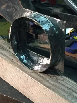

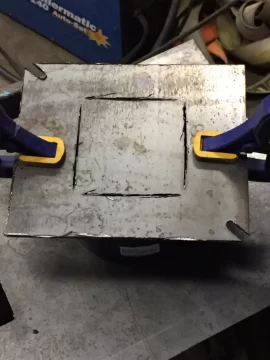

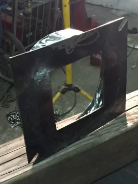

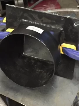

Been a bit busy here, welding an adapter for my Tigex draft enducer. Finished it tonight, just waiting on some high heat paint tomorrow. Stores were all closed today
