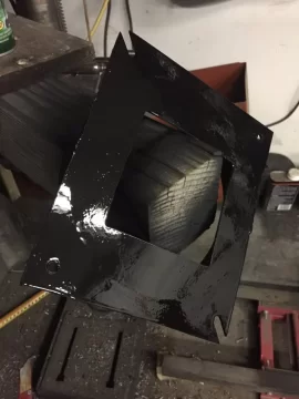

So i have been studying this this afternoon after installing the Tigex draft stabilizer.
The top of my buffer tank is about 165 and my return water from the zones is anout 140, i too am running a grundfoss 26-99 on low.
With the new motorized valve i would only need enough energy to replenish the return water by 25 degrees.
Not bad
Similar to the thoughts of earth shelter homes; a constant 50 means only 20-22 degrees of enrgy required to get to target of 72.
Im hoping I can get this installed this next week, next weekend ia out as I will be helpng with a big banquet here in town for the Quarter Horse Association.
Will report as the project takes shape
