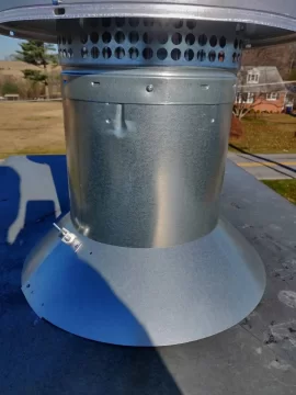

Should my storm collar sit flush with the chase cover, as in the attached picture? Or, should I leave a small gap? I know I need to seal around the top of the collar where it meets the pipe, but if I also install it flush with the chase cover, would I also seal the bottom?
Thanks in advance! This forum has helped my tremendously with my installation!View attachment 252192
In my opinion it should sit flush, having it sit high will be a cause for water leaks.

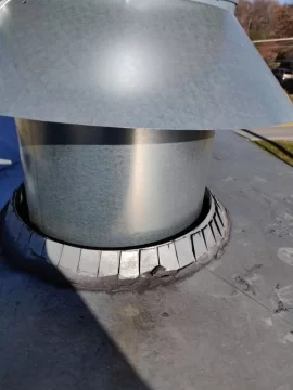

I had to finish it before anyone replied, since rain was in the forecast. I ended up leaving a half inch gap between the collar and the chase cover. Why? Ikd, just seemed ok. Still seems highly unlikely water will be an issue.

Good choice. I usually leave 1/8 to 1/4" but 1/2 is just fine
Is you chimney crown cross braked? In other words, does it have diagonal creases that raise the center? Is so and even more if not it will pay to get up there an push the storm collar down snug. What's the advantage to having it up a half inch. It just makes it easier for water to get in?
Holler, why not just loosely snug it up, to leave a little room for expansion and contraction? I just replaced my crown, and pushed the storm collar down to just touch the crown. I made my crown with a cross brake so the center is about 1" taller than the edge, plus I made a 1" collar for the storm collar to ride over. Rain would literally have to build up 2" in order to run in. If that's the case I have bigger problems to worry about. Just curious, should I raise it a bit?
I am sure it will be fine. I just prefer to leave a bit of space
