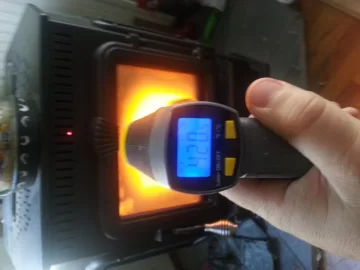

My reading on 7.

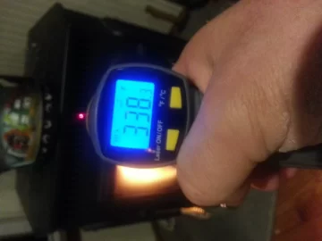

On heat range 9

200 -240'ish on setting 4 of 5 with Vermont softwoods or some of the other high quality pellets. 180 on setting 3 of 5. I can get 180-200 with just about any pellet I've tried so far. It's very hard to measure with an IR gun as emmisivity of the surface (color and texture) affects the reading and you're not measuring the air temp, you're measuring the stove surface temp (plus some of what's behind the grating). I have been using a meat thermometer but my thermocouples should be here next week. Time to wire up this stove for some R&D.:cool:
This is reading surface temp. Not air temp.
Yeah. Surface temp is much more variable than Air.
I measure with a K-type thermocouple. I always do a 5 bag (or more run) all my Settings are always the same. Run on Low with feed gate wide open (Quad and Heatilator thing) and take an average.
