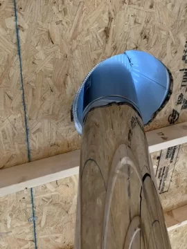

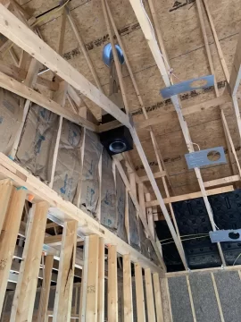

I just had this roughed in for a new wood stove I am installing. Does this look correct?
[Hearth.com] Stove chimney correct?[Hearth.com] Stove chimney correct?
I see the ceiling support box, and is that wood around the chimney? I think you’d have to measure it to know if the clearances are met.
If the chimney pipe has 2" or more clearance to any combustible, then it's good.
