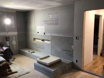

This is what I’m working with. The measurements I gave account for 1 inch stone on that back wall.

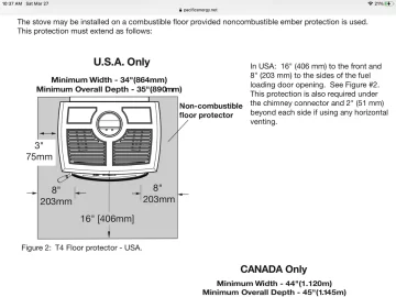

The hearth looks a bit shallow. What is the depth? Does the stove have the AC02710 heat shield? The minimum is about 41" with that shield and double-wall connector.
The hearth is 44 inches (the stone and hearthstones add 2.5 inches to what’s there- 1 inch stone plus 1.5 inch overhang) My hearthstones are 22 inch plus there will probably be a 3/8 grout.
the plan is to set the hearthstones first, then do the rock on the wall so that will eat a bit. The thickest stones are 1 inch but more are .5 inch)

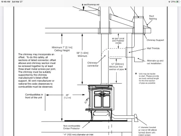

So you came right out of the stove with the 45? I thought I had read that they require a minimum of 12 inch pipe out of the stove? (Found the pic from the online manual- is that 12 inch notation just if using a 90?)
[Hearth.com] Stove / chimney pipe brands, offsets and general Q’s [Hearth.com] Stove / chimney pipe brands, offsets and general Q’s
Normally it is recommneded to be higher, especially with a minimal height flue. We have a 20' total height flue and draft is not an issue, especially with the PE. I tried the offset near the ceiling and she thought it looked better down low, so I switched and agree. The offset draws less visual attention closer to the stove than up at the ceiling. Yes, the 12" is for a 90º elbow. If I were coming off the stove with a 90º then I would definitely recommend going vertical first for at least 12", preferably more.
That'll work with the rear heatshield on the stove.
