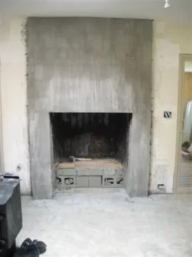

Im about to install a new Centurion wood stove as the one shown in the image attached here. Im installing it in an existing masonry fireplace/chimney. I have removed the bottom of the fireplace and would like to place the stove there, on the floor half inside the old fireplace, right underneath the chimney. I have a few questions regarding that:
