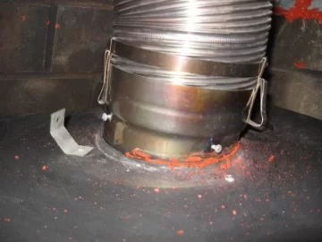

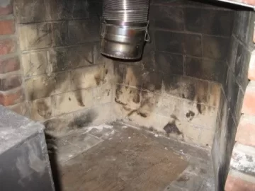

So I think I screwed up my stove connector, long story short when I was pushing the insert back in I 'dented' it on the raised lip of the 6" insert hole. Once all put together, shone a light up and cussed when I saw a sliver of light, put some high temp. caulk on it, which prompted failed and got me in trouble with the Mrs. when the alarm went off. So I need to unfortunately pull this heavy bas$##% out again and start over. Liner is fully installed at top, I pulled out for a cleaning, inspect, and install of block plate.
So what is a top 'o the line stove connector, I wanna make sure this puppy is submarine tight when I get done with it, I guess I could bend the connector back to round but something tells me maybe there is a better way or product for this ?

First problem is, you used hi-temp silicone where furnace cement should have been used. That hi-temp silicone will never last on the connector.
How bad is it dented? Might be able to re-round or straighten back out & set it in furnace cement, not silicone.
Silicone good for block off plate perimeter. Bad for stove outlet and where liner goes through block off plate. Clean that crap off real good or now the furnace cement won't adhere. And also clean it so it doesn't by chance flame up.

Make sure you clean the silicone off real well, and when ya think its good and clean, use some rubbing alcohol and clean the surface one more time with it. Set a nice bead of furnace cement in the inside lip edge of the outlet on the stove and then set the adapter down into it. If need be put another bead around the outside of that seam after the adapter is in place & secured. If you can get to the stove outlet from inside the stove, after all is in place and sealed, smooth out the cement that you put inside the stove outlet lip around the outlet and adapter edge seam. Be careful as that stainless will cut you quick & good . Take your time.
