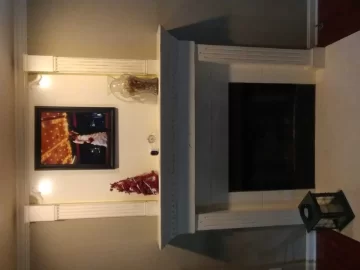

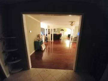

My wife and I recently moved into a new-to-us two-story house with a basement that has approx 3900 sq ft. On the main level there are two gas fireplaces, one in the dining room and the other (ventless) in the single-story family room addition on the back of the house (approx 19' deep). The main level is fairly open, with a large open doorway from the foyer to the dining room and archways from the dining room and kitchen to the family room. All of the bedrooms that we will be using are on the second floor (above the dining room and kitchen) up the stairs from the foyer mentioned previously.
My plan is to remove the ventless fireplace, rock over the wall where the current hearth is and purchase a freestanding stove. In researching the seemingly endless brands and models of stoves, I came across some literature that says it is not recommended to place a chimney on the outside edge of a house that has multiple roof levels (two-story with single story rear addition in our case) due to possible draft issues. Dilemma #1 - can this be done and what should I plan for in doing so?

Thanks for the feedback, even though that's not what I wanted to hear. That being said, is it impossible or just expensive to remove the vented gas fireplace that is in the dining room and run a rear vented stove through the masonry chimney? With the gas fireplace that is currently there, what type of flue/chimney is most likely installed in the chase?

The old gas unit has to come out. And will need a new stack rated for wood. Everything that is for the gas is a no go for wood burning.

I realize the old gas unit would have to come out. Will that have to be what people generally refer to as a stainless liner to be installed or is that something else?

If I understand correctly......you want to put a free standing stove in the "addition" that is 19' deep? Your concerns are that because the "addition" is only single storey, and is attached to a 2 storey home? I think this should be a doable situation and fairly easy and relatively cheaper than messing with your gas fireplace. I hazard to guess that 2nd storey windows would create a taller chimney if they are present. The install experts should chime in.
Yes, that is correct. I would rather have a free-standing as I think this would be the more economical/effective heating option. If I understand you correctly, I will need to take the chimney up past the 2nd story windows? Makes sense...

This is where the pro's will comment....in your ideal location, how far are you away from the 2nd storey wall? The full 17-19'? I'm sure there must be a distance that will come into effect from the windows
By the time I come off the back wall for necessary clearance, it will be right around 17' from the back of the 2nd-story wall.

The gas flue will most likely have to come out completely and be replaced with class A chimney to the ceiling level and then stove pipe between the chimney's ceiling support and the stove.
